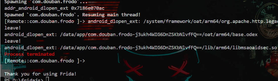

如下,可以看到加载完libmsaoaidsec.so之后程序就退出了。

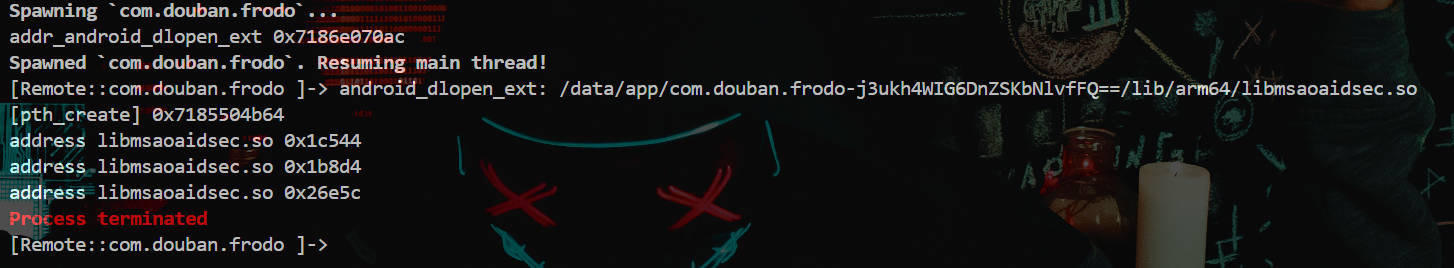

  20. function hook_pthread() {
  21.     var pth_create = Module.findExportByName("libc.so", "pthread_create");
  22.     console.log("[pth_create]", pth_create);
  23.     Interceptor.attach(pth_create, {
  24.         onEnter: function (args) {
  25.             var module = Process.findModuleByAddress(args[2]);
  26.             if (module != null) {
  27.                 console.log("address", module.name, args[2].sub(module.base));
  28.             }
  29.         },
  30.         onLeave: function (retval) {}
  31.     });
  32. }
  33. function main(){
  34.     hook_dlopen()
  35. }
  36. main()
如下看打印结果,有兴趣的小伙伴可以利用IDA反编译libmsaoaidsec.so跳转到这些地址去看这些函数都干了什么事情

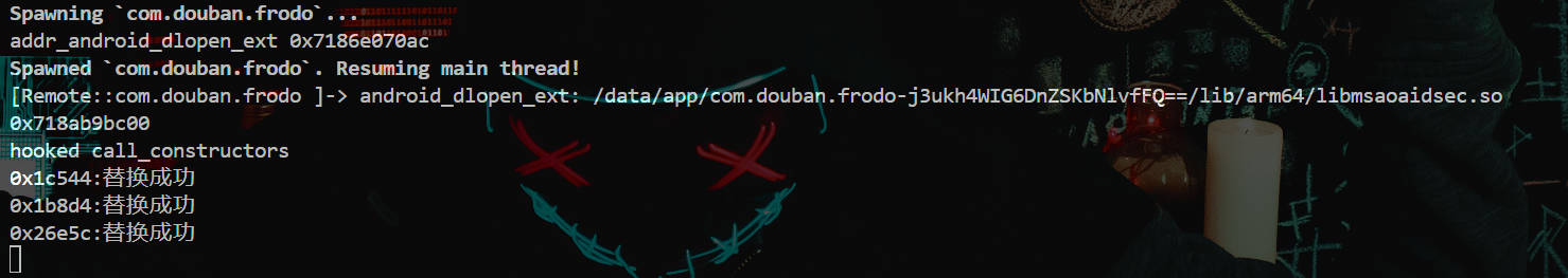

姿势1
替换函数
  1. function hook_dlopen(){
  2.     //Android8.0之后加载so通过android_dlopen_ext函数
  3.     var android_dlopen_ext = Module.findExportByName(null,"android_dlopen_ext");
  4.     console.log("addr_android_dlopen_ext",android_dlopen_ext);
  5.     Interceptor.attach(android_dlopen_ext,{
  6.         onEnter:function(args){
  7.             var pathptr = args[0];
  8.             if(pathptr!=null && pathptr != undefined){
  9.                 var path = ptr(pathptr).readCString();
  10.                 if(path.indexOf("libmsaoaidsec.so")!=-1){
  11.                     console.log("android_dlopen_ext:",path);
  12.                     hook_call_constructors()
  13.                 }
  14.             }
  15.         },
  16.         onLeave:function(retvel){
  17.             //console.log("leave!");
  18.         }
  19.     })
  20. }
  21. function hook_call_constructors() {
  22.     let linker = null;
  23.     if (Process.pointerSize === 4) {
  24.         linker = Process.findModuleByName("linker");
  25.     } else {
  26.         linker = Process.findModuleByName("linker64");
  27.     }
  28.     let call_constructors_addr, get_soname
  29.     let symbols = linker.enumerateSymbols();
  30.     for (let index = 0; index < symbols.length; index++) {
  31.         let symbol = symbols[index];
  32.         if (symbol.name === "__dl__ZN6soinfo17call_constructorsEv") {
  33.             call_constructors_addr = symbol.address;
  34.         } else if (symbol.name === "__dl__ZNK6soinfo10get_sonameEv") {
  35.             get_soname = new NativeFunction(symbol.address, "pointer", ["pointer"]);
  36.         }
  37.     }
  38.     console.log(call_constructors_addr)
  39.     var listener = Interceptor.attach(call_constructors_addr, {
  40.         onEnter: function (args) {
  41.             console.log("hooked call_constructors")
  42.             var module = Process.findModuleByName("libmsaoaidsec.so")
  43.             if (module != null) {
  44.                 Interceptor.replace(module.base.add(0x1c544), new NativeCallback(function () {
  45.                     console.log("0x1c544:替换成功")
  46.                 }, "void", []))
  47.                 Interceptor.replace(module.base.add(0x1b8d4), new NativeCallback(function () {
  48.                     console.log("0x1b8d4:替换成功")
  49.                 }, "void", []))
  50.                 Interceptor.replace(module.base.add(0x26e5c), new NativeCallback(function () {
  51.                     console.log("0x26e5c:替换成功")
  52.                 }, "void", []))
  53.                 listener.detach()
  54.             }
  55.
  56.         },
  57.     })
  58. }
  59. function main(){
  60.     hook_dlopen()
  61. }
  62. main()
如下成功绕过了
